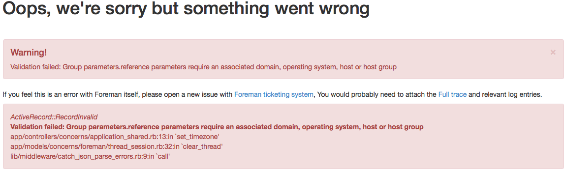

Oops, we're sorry but something went wrong
 Warning!Validation failed: Group parameters.reference parameters require an associated domain, operating system, host or host group
 ActiveRecord::RecordInvalid
 app/controllers/concerns/application_shared.rb:13:in `set_timezone'
app/models/concerns/foreman/thread_session.rb:32:in `clear_thread'
lib/middleware/catch_json_parse_errors.rb:9:in `call'

Screen Shot 2015-06-02 at 4.35.01 PM.png View Screen Shot 2015-06-02 at 4.35.01 PM.png 71.4 KB Error screenshot Jamin Ragle, 06/03/2015 11:55 AM
