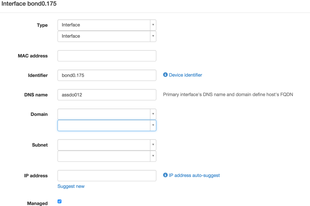

In foreman 1.9.x I have seen that the edit interface form gets corrupted when adding a virtual interface on a bond. At first the dropdowns are empty. Then if you save current edits and re-edit the interface the drop-down boxes double up and form looks corrupted
doubled_up_interface.png View doubled_up_interface.png 63.3 KB Doubled up interface screen Byron Miller, 10/21/2015 12:11 PM

What happens is I have a host that is discovered by discover image, i click provision, i add a bond0 with 2 interfaces attached, i then go add a bond0.vlan and when i click to add this interface on vlan0 the screen is blank - i can't do the dropdowns, but i go click virtual and add the vlan info and save, then i go back and edit and then the screens are garbled and dropdowns duplicated.

I just tried it on creating a new host and same issue, if i try and create a virtual interface none of the dropdowns are user selectable. I have to create the interface and then go back and edit it and once i do that, it doubles the dropdown lists.

I noticed if i go backwards, create the virtual interface first i don't seem to see the corrupted form but if i create bond0 first i get the weirdness where i can't chose the dropdown boxes.
