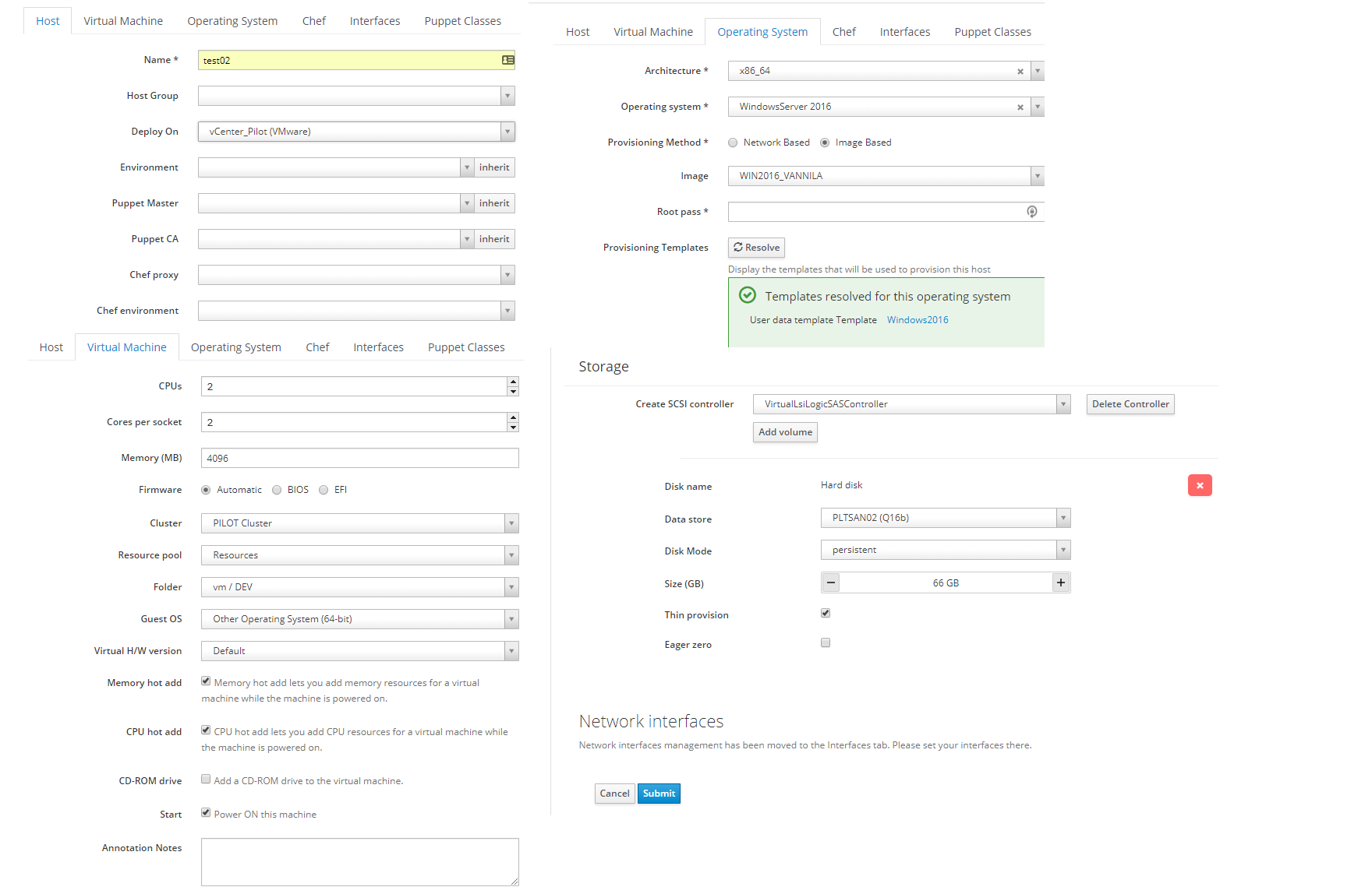

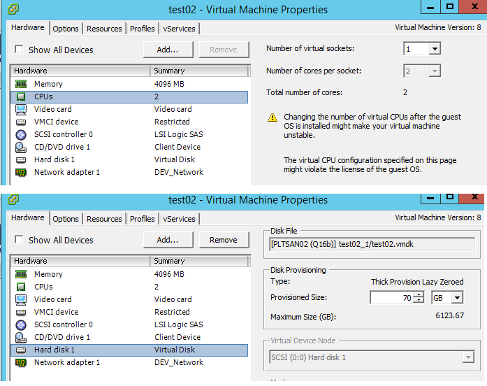

When creating a new VM I notice that some of the “hw” is not created as requested on the Foreman form - RAM usually works fine but the CPU/Core count is wrong, the disk is created as Thick although i checked Thin, can’t create an additional disk and some of the vm options are wrong (allow hot add mem and CPU).
I attached a few file - a screen shot of the create host form on Foreman, the provisioning template in case you think its related and the created VM properties.

VM properties.png View VM properties.png 31.9 KB Eli Katz, 03/21/2018 01:06 PM
Create Host form.png View Create Host form.png 180 KB Eli Katz, 03/21/2018 01:06 PM
