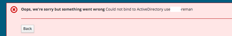

We have two foreman masters with memcached etc.
AD Ldap auth works only on the first master.

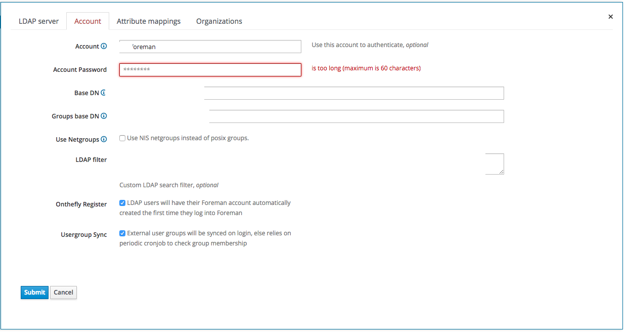

When I login under local admin account to the secondary and go to ldap settings and try to modify connector to ldap foreman complains that password is not set.
If I set up password for ldap on secondary it works fine, but master instance stops working with ldap
Screen shot attached.
We're running 1.17.1
Log:
LdapFluff::Generic::UnauthenticatedException
Could not bind to ActiveDirectory user s-foreman

I found an issue: /etc/foreman/encryption_key.rb needs to have the same ENCRYPTION_KEY across all masters.
