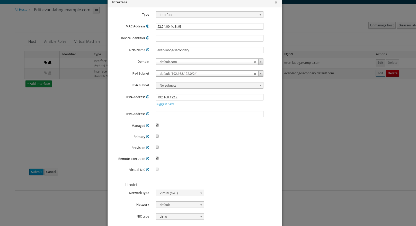

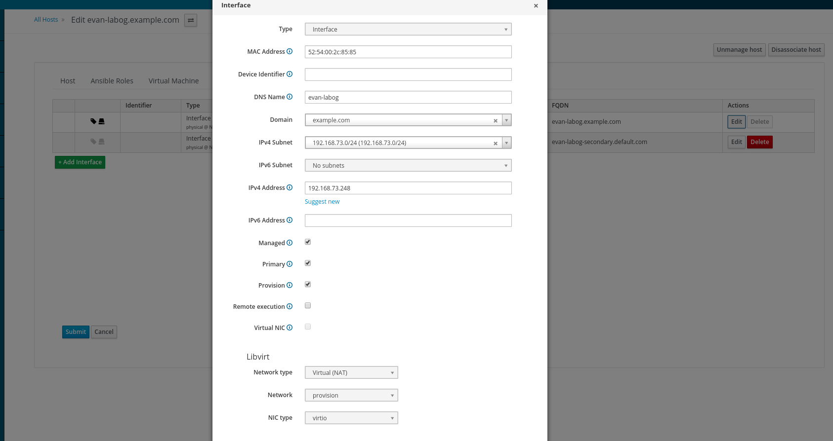

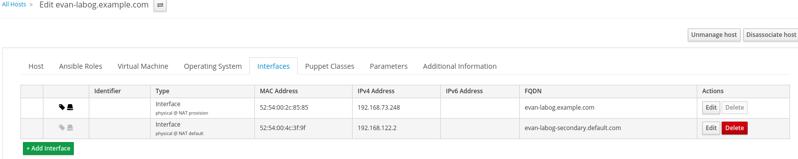

1) Create a host with 2 interfaces - one as primary and provision without rex, the other with rex - see screenshots for details

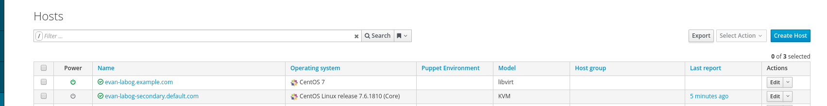

3) notice second host with fqdn of the secondary interface was created
secondary.png View secondary.png 88.5 KB Ondřej Pražák, 01/08/2019 01:51 PM
primary-provision.png View primary-provision.png 90.6 KB Ondřej Pražák, 01/08/2019 01:51 PM
duplicate-hosts.png View duplicate-hosts.png 37 KB Ondřej Pražák, 01/08/2019 01:51 PM
two-ifaces.png View two-ifaces.png 48.4 KB Ondřej Pražák, 01/08/2019 01:51 PM
