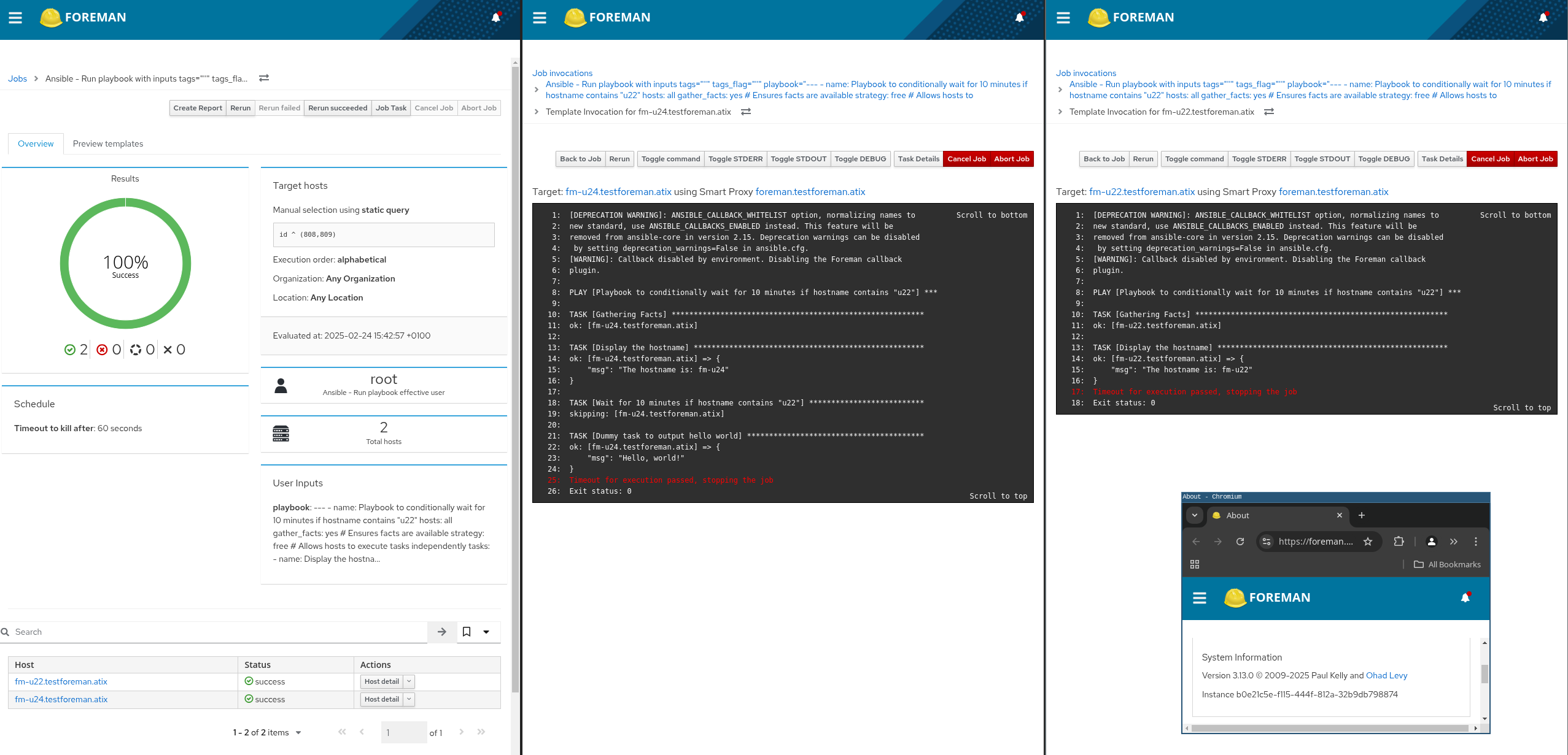

When a ansible playbook is executed as remote job on several hosts, there is the possibility to set a "timeout to kill". If the playbook hangs on one of the hosts and the timeout is reached, the execution on all hosts is terminated. However, the status that is show in the Foreman UI is ✅success for all of the hosts, see also the attached screenshot for an overview of the problem. Tested with foreman 3.13.0

The playbook has a task that delays for 10 minutes only on the hosts whose hostname matches the pattern set in step 3, so while the other tasks on the other hosts run through, this one host hangs and triggers the "timeout to kill".
Actual results:
the job gets terminated after the timeout, and shows that the job was executed on all hosts successfully
Expected results:
at least on the host where `pattern` is in the hostname and that therefore waits 10 minutes in an ansible task, the status should be "failed" and not successful
ansible_playbook_timeout.png View ansible_playbook_timeout.png 286 KB Screenshot illustrating the problem Martin Spiessl, 02/24/2025 02:50 PM
