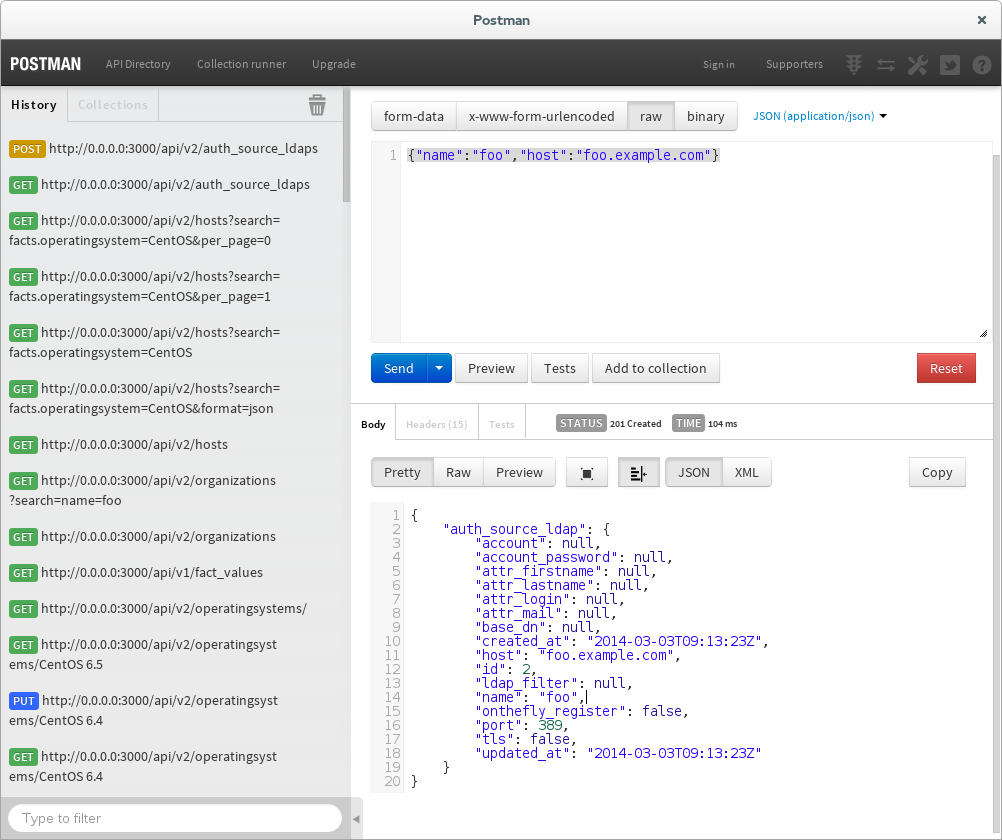

Try getting rid of the outer hash when POSTing, I just tried submitting this and it worked:
POST /api/v2/auth_source_ldaps
{"name":"foo","host":"foo.example.com"}
Status: 201 Created
Updated by Dominic Cleal over 11 years ago
  • Status changed from New to Feedback
Oh, and be sure to specify "Content-Type: application/json" since you're uploading JSON.
Your curl examples are missing the Content-Type header. Note that "Accept" isn't the same (that's saying what content you accept back from the server) as "Content-Type" (which is the content you're sending). without this header, it'll assume you're using regular form encoded data instead.
Add
-H "Content-Type:application/json"
I also used Postman to test this earlier, see the screenshot for how I've set it up (Raw, application/json on the right).
